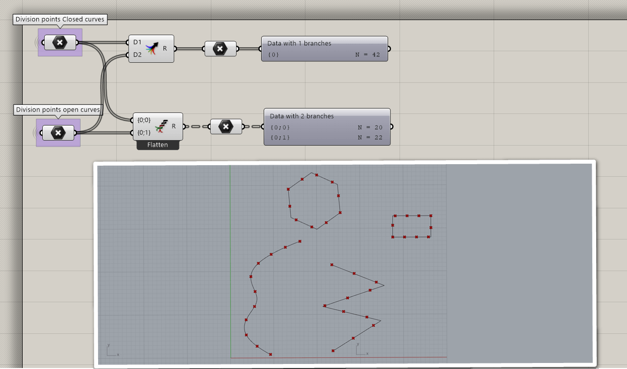

In the example below, I have some division points from some curves. I separated them into the division points from the closed curves and division points from the open curves. Now you might say, I don't care that some points are from curves that are open or closed, I just want to generate a curve profile on those spots, extrude that profile curve and get my columns. Here the merge component would work best.
But If you do care that some of those points are from a closed curve, because that means the columns will have some sort of restriction for instance. You'd be better of using the entwine component.
