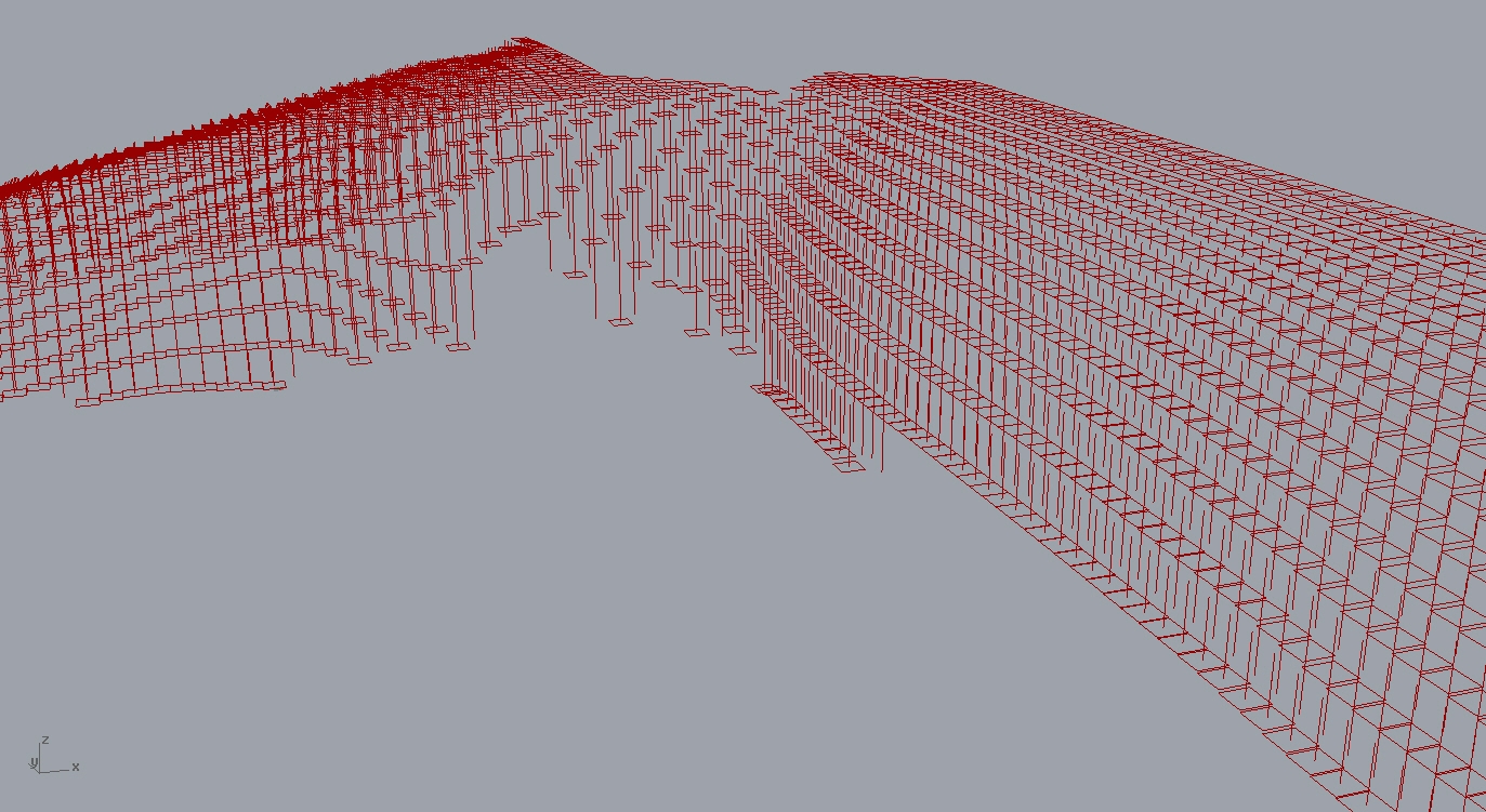

I believe this is because of your bricks' orientation. @7:55 I use a X direction Vector component, for the extrusion direction. This is kind of on purpose as I explained in lesson 2, I believe. I orientated my pavilion on the YZ-plane, so I could use a simple X Vector for the direction.
In your case, your rectangles are orientated on the XY-plane, which means you should be able to use the Z Vector component. Let me know if this worked, looks bad-ass man! Glad to see your fiddling around and creating your own design/structure!

Hi Arie,
Firstly, thank you for such a quick response. Secondly, I think the issue comes from the projected rectangles. The distance along the four corner points spill onto other lists. This means that the discontinuity lines go all over the place. I'll post some pictures so you get a better idea down below so you can get a better idea...
